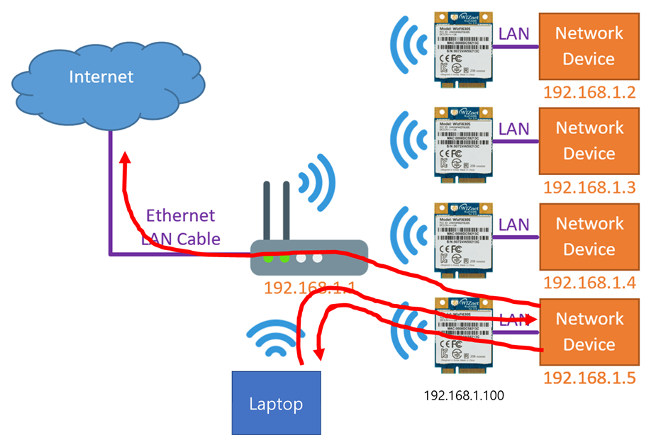

I tested the function that you wanted. and I found out how to set the module to run that function.
I set up the module and did ping test.
and the result of above tests worked well.
It is a bad news that the WizFi630S has a IP address(192.168.1.100). because WizFi630S have to connect to AP using Client Mode.
but you don’t have to worry about the IP of Client mode.
Above connection I tested allow Network Device to have two subnet.
However, the Network device can use the subnet of the AP instead of WizFi630S’s subnet.

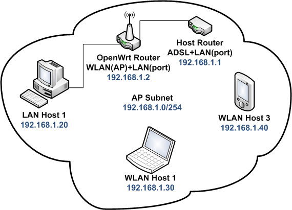

please refer to the image and description in the following link.
https://oldwiki.archive.openwrt.org/doc/recipes/relayclient

first of all, you should install ‘relayd’ package into the module.
below subnet of this configuration is ‘192.168.2.1’. but your network device should have a IP of AP’s subnet like ‘192.168.1.2’
