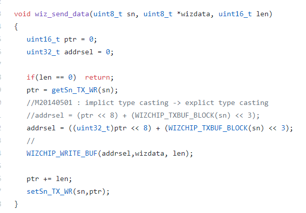

The procedure for sending data is as above.
You must first read the address via TX_WR and write the data to that address.
Please refer to ioLibrary Driver code.

instead of initial value (0x0000) I get some weird values and thats the problem. The values I get are above my TX buffer free size limit
