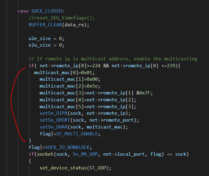

W7500-S2E supports multicast operation and you can download the firmware through github site and modify the firmware.
If you downloaded the firmware of W7500-S2E , you need to see the source code of this path in " Projects/S2E_App/src/Serial_to_Ethernet/seg.c".
For using multicast , you have to set the multicast flag before socket open .
If you can modify the firmware(W5500S2E) like I said, you can just modified it.
If no, I think it would be better to use W7500-S2E.
This link is the firmware of W7500-S2E.
https://github.com/WIZnet/WIZ750SR

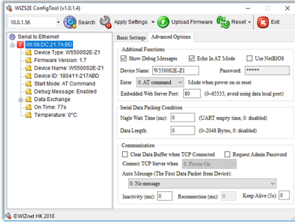

We try to send ArtPollReply 281 bytes, and we see these bytes are separated into several UDP packet.
Is there some way we can do that we want to receive all bytes in one UDP packet? Thank you.
RE: RE: About W5500S2E-S1 receive sACN packet
In configuration tool, Advanced Option ->Serial Data Packing condition → Data Length
If you want to use the byte count, you can fill in Data Length.
