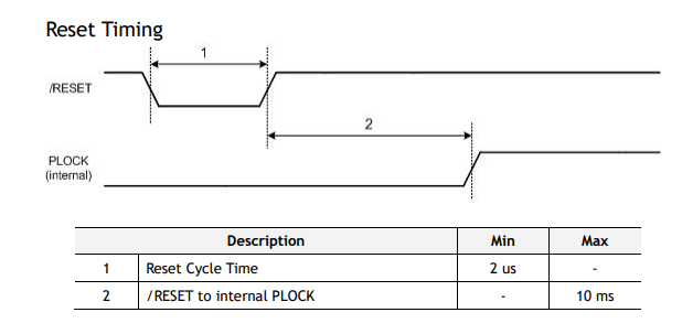

The figure below shows the reset timing.
10ms have passed since the HW reset was pressed and you have to confirm the Link blink whether or not.
I tested them.
I tested and it doesn’t slow response to ping like you said.
I think it could be a hardware problem.
Could you please tell me that DHCP use whether or not?
