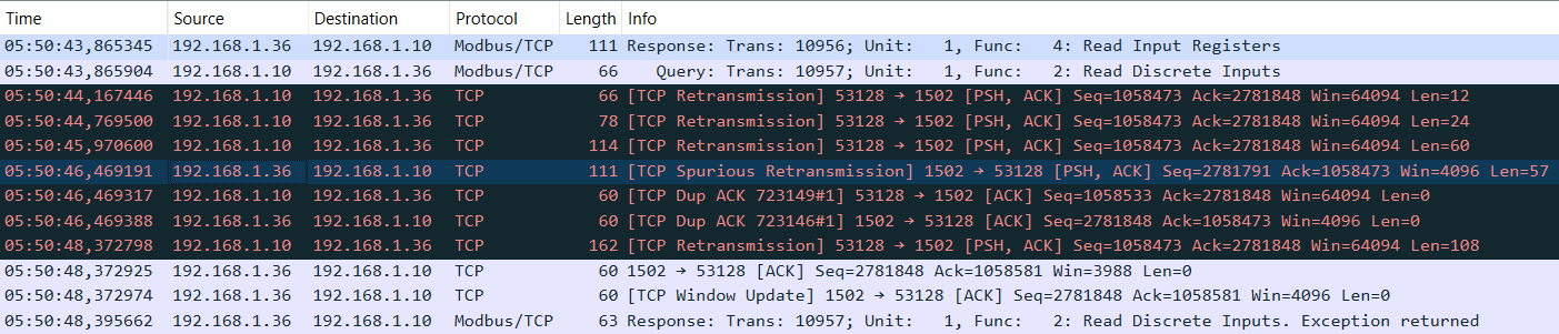

This is what I see, and it’s always the same packet pattern.
The 1st packet from IP .36 (wiznet) after blindness, in the black area, is a retransmission of the reply to the previous message (the 1st packet in the image). So 7500P spent at least 2.6s without seeing TCP/IP packets.
The last packet in the image is a modbus error message because all the IP .10 retries were sent to the 7500P’s serial port as a single message and rejected by the modbus server on the other end of the serial port as a wrong message.
