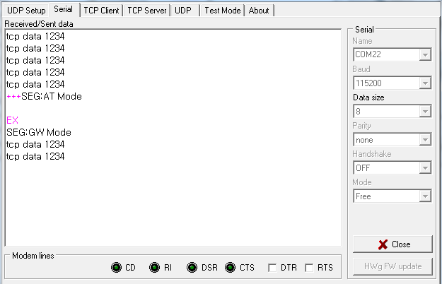

Serial port command operating on WIZ752SR-125
RE: Serial port command operating on WIZ752SR-125
by JamesMassey ·
I think you need a null modem cable between the WIZ752SR-125 and your PC
James
by lawrence WIZnet ·
Hi, @Georgij_Batyuchenko
SS command is used to read current trigger code or write new trigger code.
To enter command mode from data mode, you need to send trigger code, +++.
And to enter data mode from command mode, you need to send command, EX.
