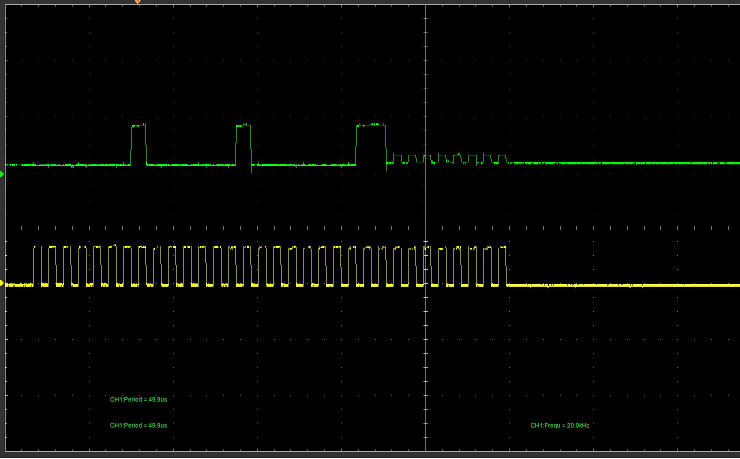

in addition i want to check the version of the chip via scope, this is look reasonable?
don’t pay attention to the noise i am checking this problem

What is this? You did not provide signal names, what exactly you expect to see, and what we should check it against.
