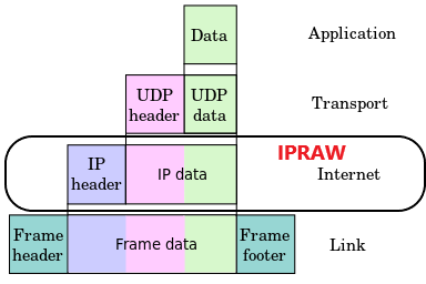

Hi~ As far as I know, if you want to use RTSP, you should use TCP. But RTP can use TCP or UDP selectively.
IPRAW data is composed of 6 byte PACKET-INFO and DATA packet. PACKET-INFO
includes sender’s information (IP address) and the length of DATA packet. So, if you use IPRAW mode, UDP packets encapsulated.
Thank you!
RE: RE: Why does Wiznet W5300 IPRAW socket mode not recieve UDP/TCP packets?
by hammi ·
Dear Irina
Thank you very much for your reply. No doubt IP layer packet does contain UDP data but hardwired TCP/IP protocol stack of wiznet w5300 does not allow to receive UDP packets using IPRAW communication mode. So I am not able to receive UDP/TCP packets in IPRAW communication mode.
