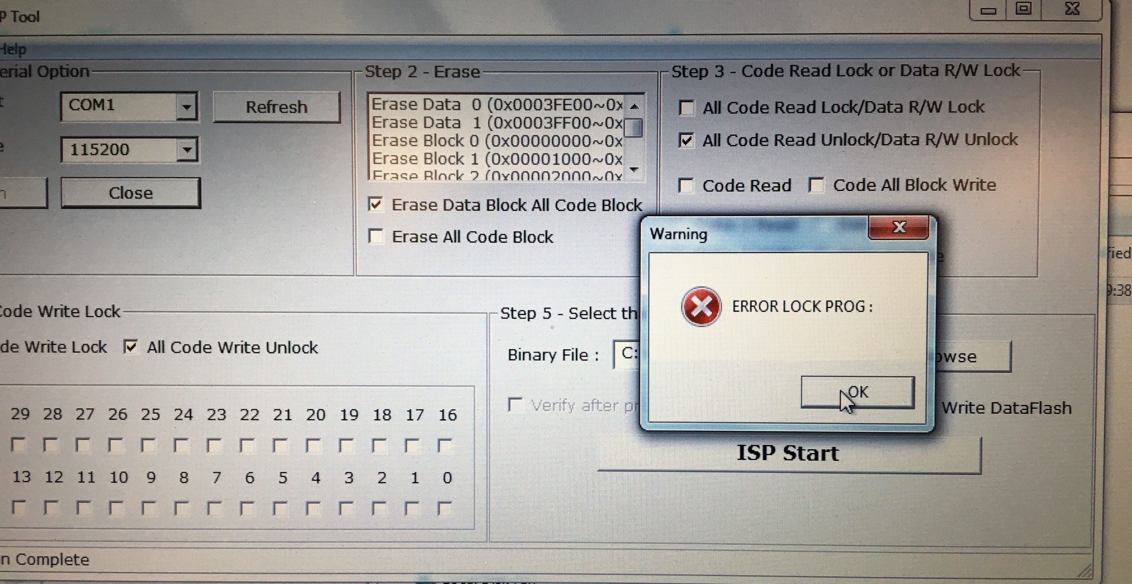

Hi - when programming some chips using the W7500 ISP tool we get the error
ERROR LOCK PROG:
is there any way this can be avoided?
Thanks!
RE: how are W7500P chips delivered?
by phenningny ·
when programming some W7500P chips using the W7500 ISP tool we get the error and it does not allow us to flash new firmware.
This is the screen we see (attached). What actions can we take to be able to flash?
Thanks!
by Edward ·
Hi.
First, Did you set to boot pin to active high?
If you set to boot pin to active high, You possible connected to ISP serial access.
And I think, W7500P still have locking.
So, check to sequence to below list. (below list is W7500P make to unlock mode way)
And exit to ISP program.
And then reexcute ISP program.

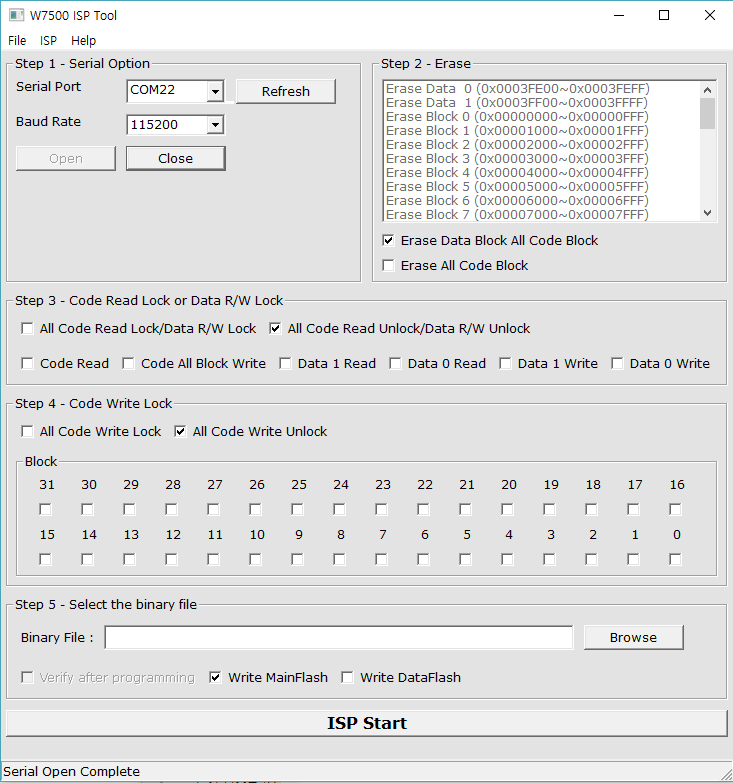

If you successfully unlock to W7500P, ISP tool show to same below picture.
If ISP tool show to same below picture, You possible W7500P memory R/W.
