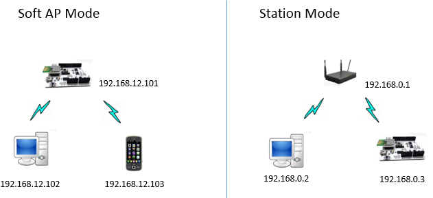

RE: Wizfi250 host name ?
Hi!
→ I Think you’ll understand when you look at the picture below.
→ You mean, your environment is like this?
When you use a WizFi250 as a STA mode, WizFi250 can get a dynamic IP(192.~) from AP using DHCP.
→ I am sorry though, from what I know there is no way to give a special name to a WizFi250(STA).
If you hava a question, please ask !
