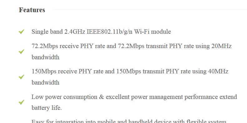

Hi, I try to explain. I use my WizFi 310 in AP mode. My configuration set 20MHz bandwidth and I suppose I use only 72.2Mbps rate. I learn about the possibility to speed up my Wi-Fi transfer thanks to extend bandtwidth to 40MHz (from WizFi 310 datasheet). I don’t know AT command to switch to 40MHz.

I am sorry to say WizFi310 doesn’t support that function
Have a nice day !!

OK, WizFi website contain mistake.

Thank you for letting us know that.
Also, I am sorry to have confused you.
We’ll fix that.
