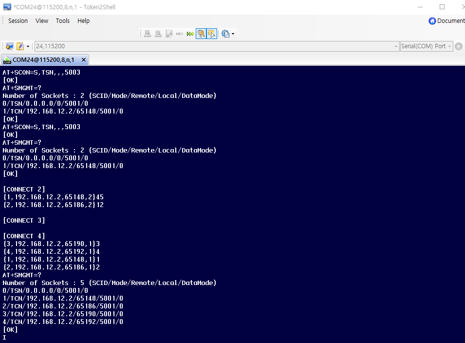

I tested multi-connection with a WizFi310.
I operate a WizFi310 as a TCP server and my PC connects to WizFi310 as a TCP client.
I attached a capture below.
This is WizFi310 Serial Capture.
As you can see, WizFi310 receive a message from 4 TCP client.

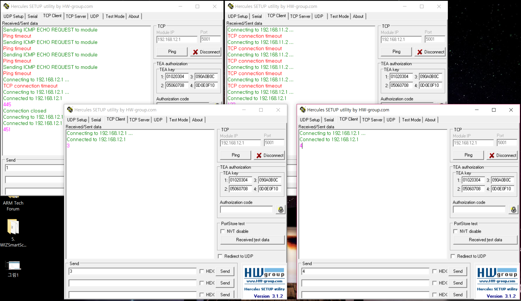

And this is PC( 4 TCP client) capture.
I hope it will be helpful.
