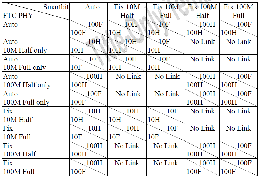

What is the intention to change the MAC address.
If you can connect to an layer 2, I don’t think it’s a matter of MAC address.
When you try to connect to an layer 3, does the link led light up?
If it doesn’t light up, you should check the settings.
If the speed is fixed at 100M, the setting on the switch must be FIx or Auto at 100M.
