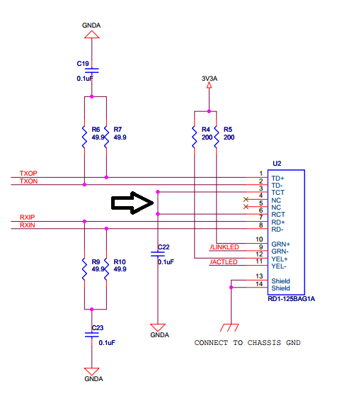

There’s a reference schematic how the chip should be used (connected). Can you please explain the purpose of your questions.

OK, I Saw the reference schematic and checked it. In the reference schematic, center tap connect to VCC 3V3A and a 0.1Uf capacitor. BUT in my new design i can not connect VCC to center tap illustrate in below figure:
But i don’t know it is possible or not??
RE: Center tap of transformer
Let me answer the following way:
Reference schematic is the way manufacturer (WIZnet) guarantees operation of its product (W5300). Consequences of all deviations from this schematic is a responsibility of the designer.
Unless someone from WIZnet development confirms you that your design will work the way you want it to have, you are not formally guaranteed your result.
If I would be you I would find a way to comply to the reference schematic - in other words connect the wire you point at to 3V3A. Probably it is the right problem to solve?
