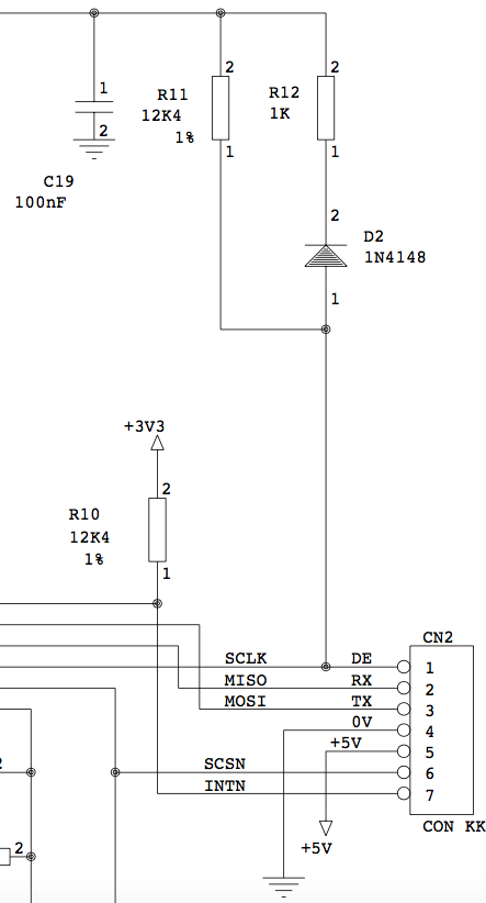

For those that do not have extra pins for controlling a W5500 Reset pin or SCSn pin to use variable lenght data mode , it is possible to add a very simple reset circuit from the SCLK clock pin.
Using an SPI mode #3 the clock is normally at level 1 and during activity changes to level 0 generating clock pulses but always returning to level 1 after data exchange. Configuring the SPI properly to mode 1 or setting the SCLK pin to level 0 during 5~10ms , the RST signal goes low reseting W5500.
The trick is that the time constant of the circuit is very different from 1 and 0 levels because of the diode and resistors. So during normal operation the reset signal is always above level 1, not resetting the device.
To reset the chip, in a special part of the initializing code, keep the clock low for 5~10ms. The chip will be reset and then continue to main code for operating the W5500.
This is a very economic solution to avoid using precious microcontroller pins for reset or SPI strobe.
Without this , if the W5500 gets out of sync with the microntroller during power on/off or any SW malfunction, it is not possible to recover the W5500 to a known state without a reset.
Another advantage of the circuit is that is eliminates the use of special power on reset circuits for 3V3 operation. The microcontroller may control everything, reseting the W5500 if it stops responding polling commands.
