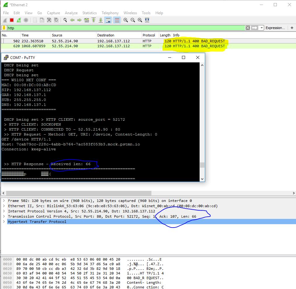

I am having a problem with the library with the wiznet 5100.
I get a bad request when sending with the library:
mngz can you tell me what you changed in the library ?
RE: How to use http client with W5100
by Fritz.Pomm ·
I also would like to know. Any further info here?
