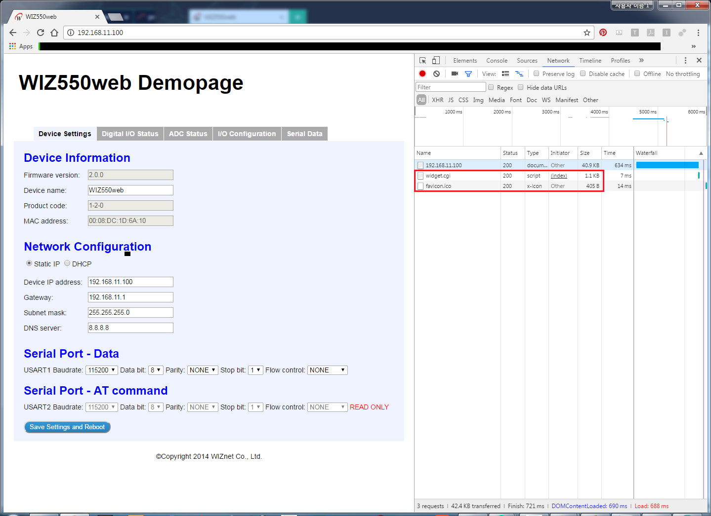

Hi, Knut.
What exactly are you talking about?
As shown below, a smaller size than the buffer size was also transferred without any problems (WIZnet icon).
I think I am misunderstanding your intentions, so please explain the exact situation.
Best regard,
Kei
