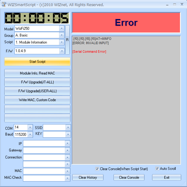

Wizspartscript?
RE: Wizspartscript?
by cliff ·
I think that it was worked well.
Please download it again and try it.
[url]http://wizwiki.net/wiki/doku.php?id=products:wizfi250:wizfi250firmware:start[/url]
best regards.
RE: Wizspartscript?
by stephaneroque ·
Thanks for your answer.
But i have an another problem. Your soft send bad command AT.
I write a program on arduino and i can to send command AT directly.

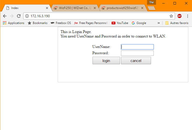

[color=#FF0000]Third problem:[/color]
How to insert my personal web pages?
thank you

Third problem:
default UserName is “admin” and Password is “admin”.

But for the third problem, i know ID and password.
I want to modify the web site and make my own web site.
perhaps, i must transfert my web site in a subdirectory on the wizfi250 server, but i don’t find an answer for this.

In third problem, actually you can’t modify the web site.
The web site is basically offered from module, so you can’t modify.
If you need, you have to make a web site.
