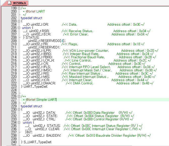

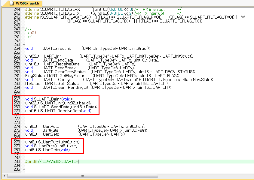

As you found, we do not have UART2 documents… but we have a plan.
Only the information of UART2 is in firmware… W7500x.h and W7500x_uart.h
We call UART2 simple_uart.
Please refer the functions and structure.
