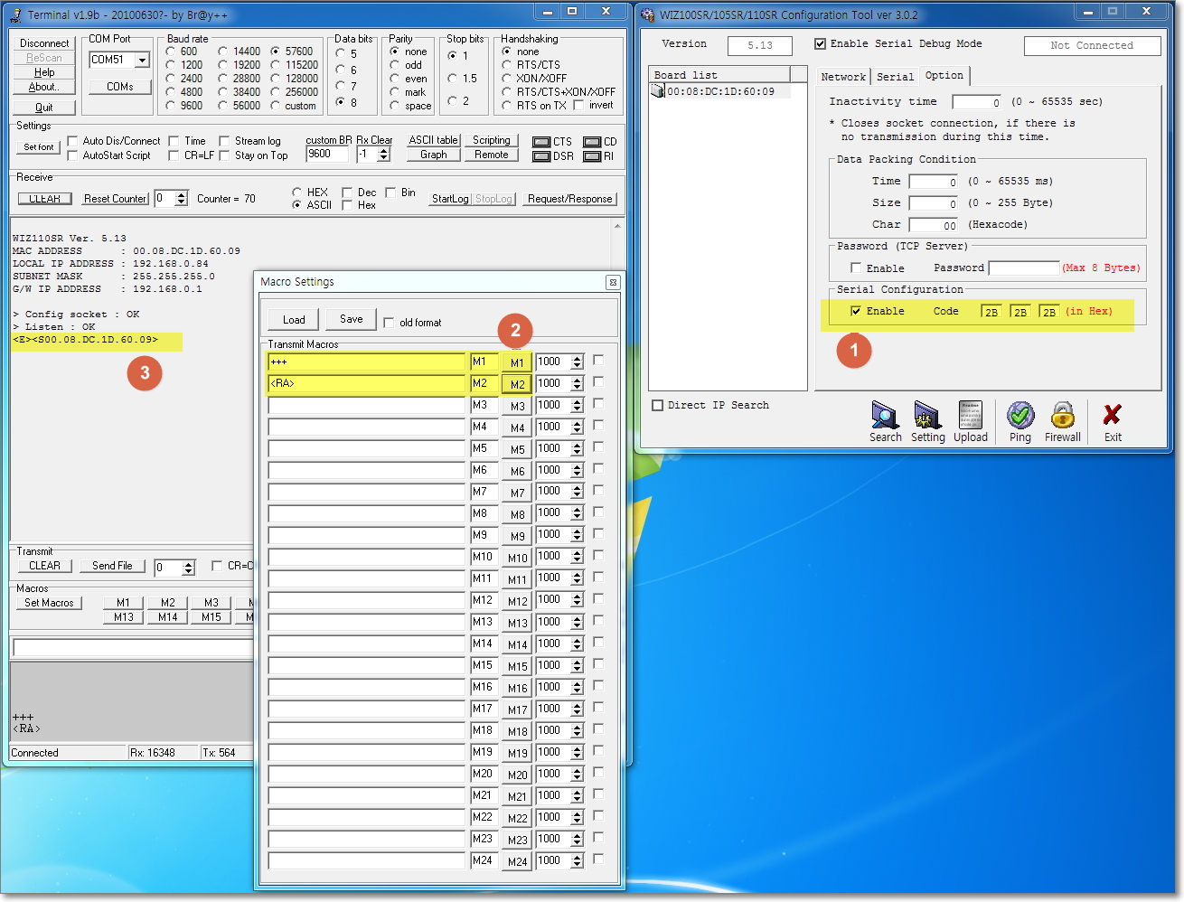

RE: WIZ110SR Mac Adress sending
by jim ·
Please refer to the attached image file.
Please read User Manual fully.
by jim ·
Dear Adrian
In case of WIZ110SR module
First, if you make the Server program, you can get the MAC address after connection. Refer to [url]Wiz110SR Set parameters using VB code]
Second, you can’t receive the MAC address from the module directly. You must get the MAC address through serial terminal. And then you transfer the MAC address to Server.
