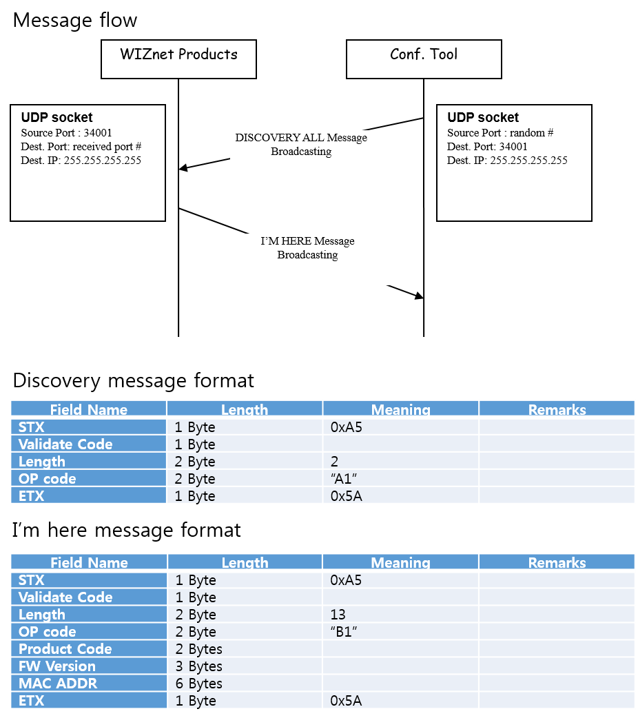

What is the UDP ports used to search for this module?

RE: What is the UDP ports used to search for this module?
by koenbielen ·
We know there is a configuration tool but we like to make our own configuration tool.
So checking your documentation we can configure the device via UDP, that info looks good to start with :
https://docs.wiznet.io/Product/S2E-Module/WIZ107SR/wiz107sr#wiz107srwiz108sr-configuration-communication-protocol-guide-v10
But one thing we are missing is the UDP command used for finding all devices on the network
is that done with a UDP broadcast packet with data “FIND” ?
Is there a description on how this search can be performed?
thank you
Kind Regards
Koen

RE: RE: What is the UDP ports used to search for this module?
by rena ·
Hi, @koenbielen.
WIZ107SR does not use ‘FIND’ packet directly.
By sending a packet with UDP broadcasting as a combination of several commands, the device(s) sends a response.
It may be helpful to refer to the WIZ750SR and Configuration Tool, which uses a nearly similar command system.
Please refer to the links below.
