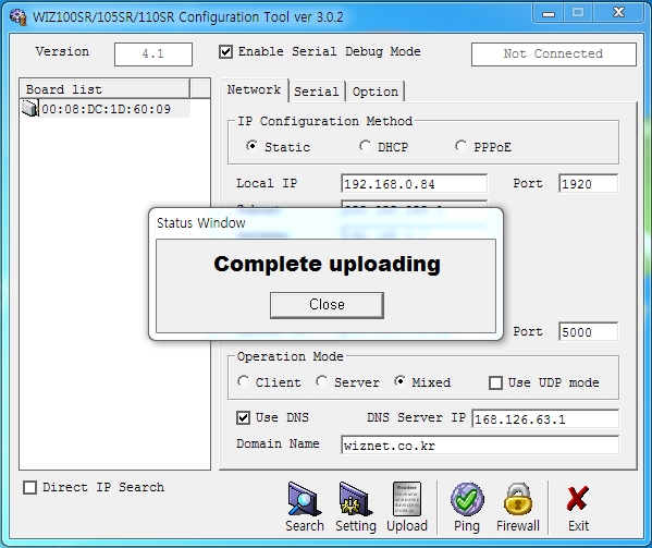

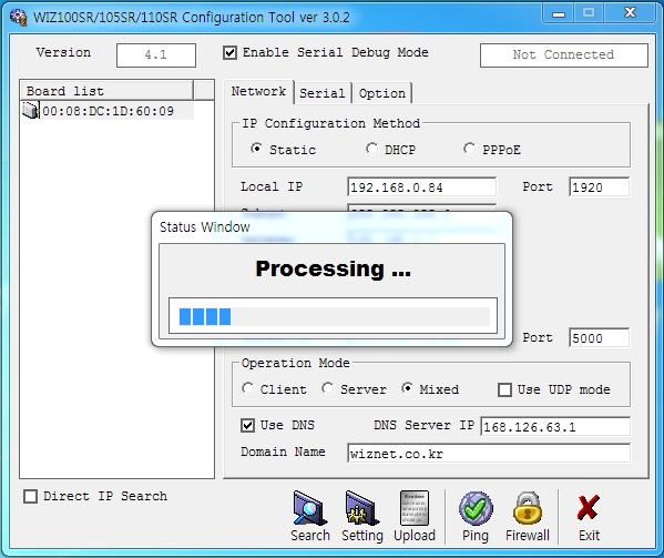

I have reproduced the upload processing.
But I didn’t find a fault.
And also I don’t know NMAP tool. I have no advice. Sorry.

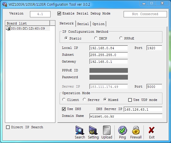

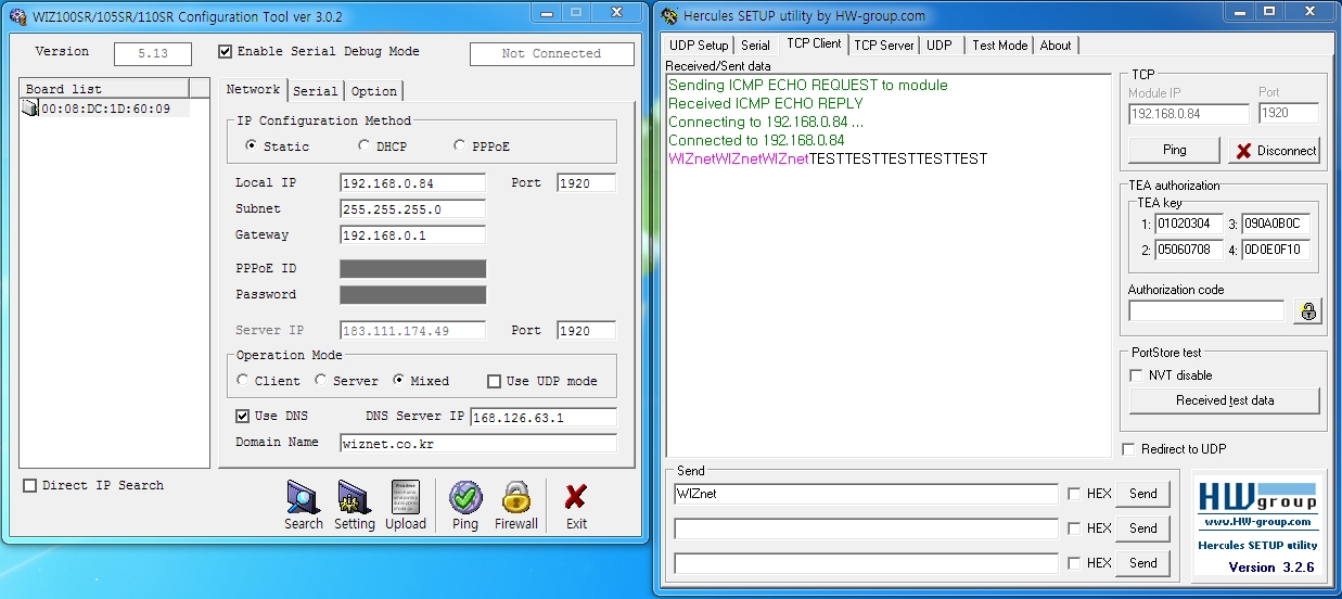

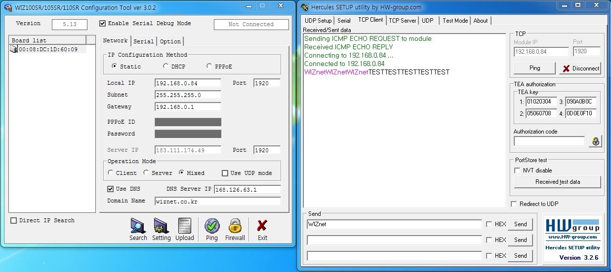

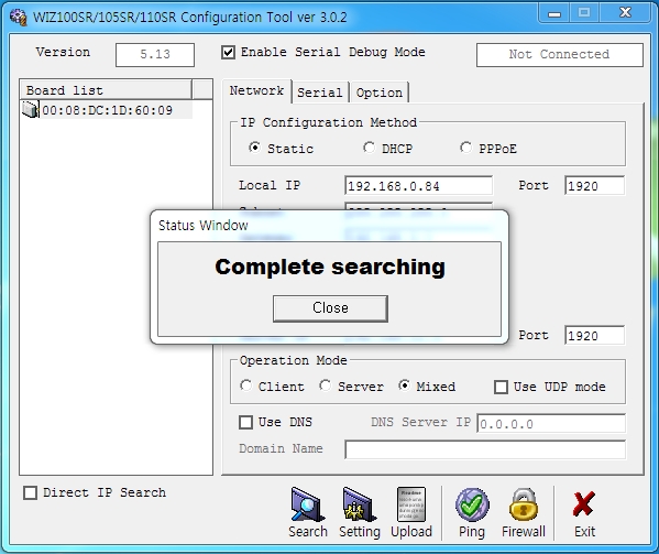

Additional images.

RE: WIZ110SR - Firmware Upgrade
by jim ·
If you use the WLAN, you should deactive that. And then try upload again.
You can see to communicate data through port 1920. (Refer to 2015-10-29_wiz110sr6.jpg )
