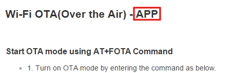

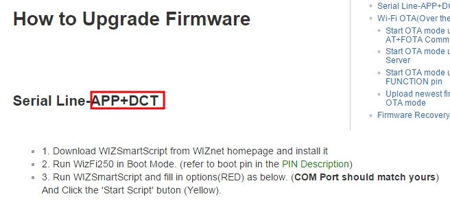

There are some flash bank in WizFi250.
Please refer to the below link.
http://wizwiki.net/wiki/
doku.php?id=products:wizfi250:wizfi250pg:firmware_upgrade
BTW, please note that if there are some major-changes in WizFi250-FW, you should re-input mac address using AT+MMAC=…
Regards,

so I’d have to use ‘Flash Write(app)’ instead of ‘Flash Write(all)’ in WizSmartScript ?
RE: Mac address lost after firmware update
by ssekim ·
It’s case by case.
Anyway, if you use ‘Flash Write(all)’, you should re-input mac address using AT+MMAC=…
