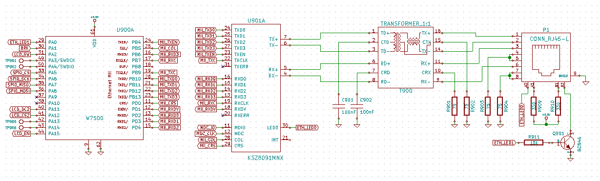

Hi anagy,
I’ve recently made a design with W7500. As i’m in europe i’ve choose an available PHY … the KSZ8091MNX. As lawrence says, i think any PHY with standard MII interface may works, but i can confirm that KSZ8091MNX is ok below, the used schematics)
Note: lot of PHY have the same pin order (rx signals first) but … IP101G not. So with IP101G pcb trace are more simple
