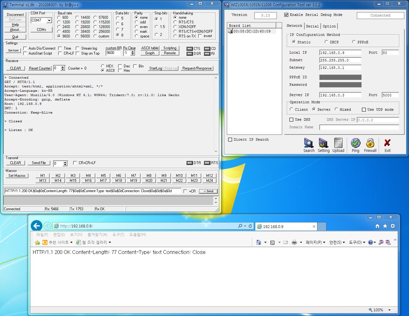

Should not the WIZ110SR receive the HTTP code request sent from a web site and pass this to the serial, and then I send from the serial the response (web page) back through the WIZ110SR to the Browser?
I have code from the Arundio forum where they are doing that and I have tried but as said the serial does not receive the “GET” request.
It does work if I use Telnet the “GET” request is received by the serial (my MCU) and then the web site code (text) is returned to the Telnet consul but of this cannot display the page.
Thanks David.
RE: WIZ110SR web page access
by jim ·
Please refer to the following.
