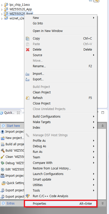

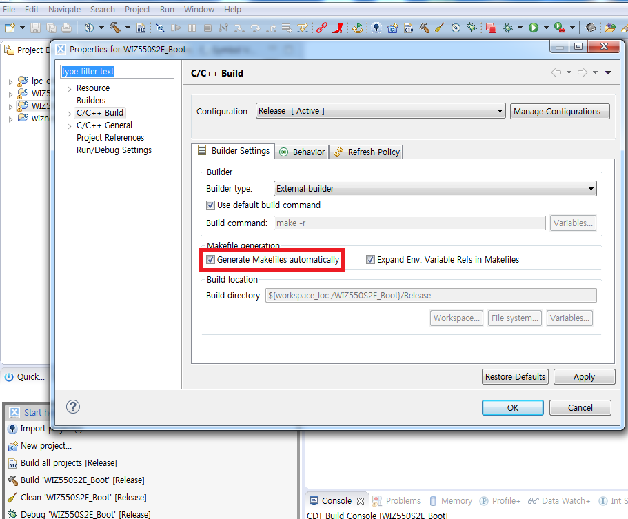

I found the problem you mentioned. I guess it is an error on the version of LPCXpresso. Please set it as below.
RE: Can't build WIZ550S2E_Boot
by MrBool ·
Hi Ricky,
thanks a lot. It works.
