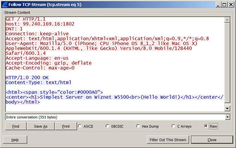

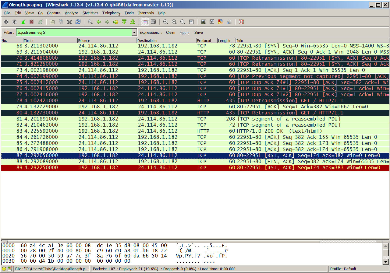

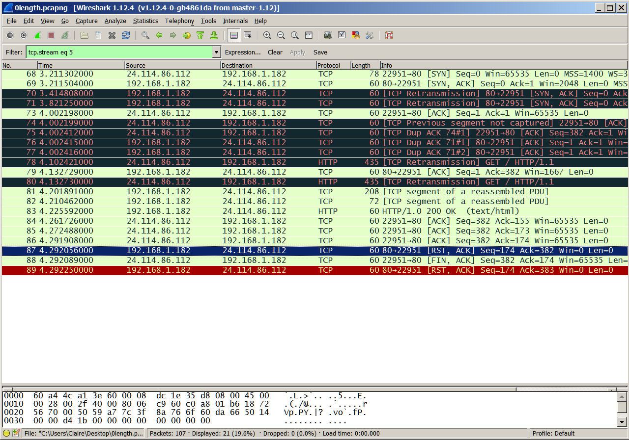

Ok: I can easily recreate the problem and I have tried to capture it.
In this case the client ip is 24.114.86.112 and the server is 192.168.1.182.
Client sends an HTTP GET, the socket status goes to 17 - session established but when I read SnRX_RSR I get 0 for approximately 200 ms. Then SnRX_RSR shows the proper length 381. I have attached the wireshark capture print as well as screengrabs of the tcp stream content and packets.
I did capture everything but I’ve limited the uploads to the tcp stream. if there’s more that would be a help please let me know.

by Bill2009 ·
Thanks for looking at the code. I have a 100ms delay in the main loop because i sometimes stream the status codes to a serial port and i don’t want to flood it.
I reduced the delay to 1ms and I found the transient 0 length happened almost every time whether the client was on the local network or not. My conclusion is that there is a perceptible lag between when the socket status goes to 17 and when the data is available.
I can live with the retries except that Chrome frequently causes a session to be established with 0 data and this never resolves so the server spins its wheels for 200ms waiting for something that never happens.
I don’t have directly comparable code but I have tried this with the W5200 and the transient 0 size does occur but less frequently. I had not seen it before because the 100ms delay pretty well masks it.
