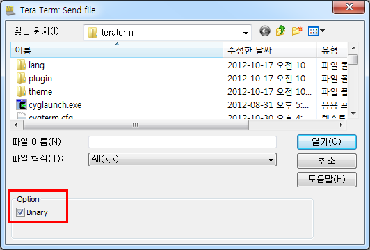

Hi
WizFi250 can change the certificates file using AT+MCERT command.
This is example for using AT+MCERT command.
Thanks
RE: RE: Certificate algorithms
by wizdaniel ·
MCERT command for writing method needs 3 parameters.
AT+MCERT=‘W’, ‘C/K/R’,‘length of file’
there is a example regarding to add default Certification file into the module.
Please remind that every ends of the lines of the certification have to have “<0x0d><0x0a>” instead of MCERT command.
the MCERT command only needs <0x0d>.
