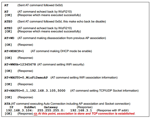

If you want to connect to AP, you can use AT Command as below.
For more information, Refer to WizFi210 Programers Guide.
[url]http://wiznet.co.kr/Admin_Root/UpLoad_Files/BoardFiles/WizFi210_PG_V130E.pdf[/url]

sori my boss want this wizfi220 login into FLOATWAY and send data to html server. your example login into WizfidemoAPP. He want me to send data into same SSID that he use to connect into internet.
Regards,
Gunawan Sinariadi
