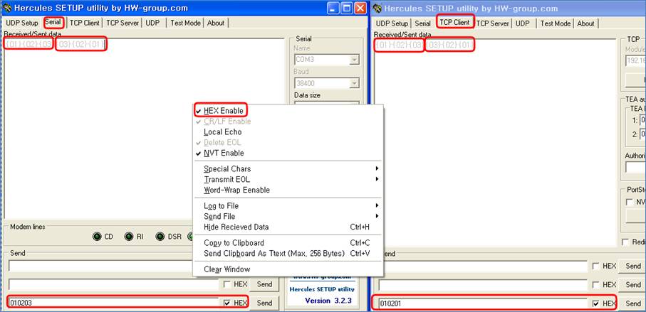

Hello arg02
As we replied via e-mail, if you use general TCP client(not telnet client), you can send any raw data(0x01 ~ 0xff).
Refer to the below screenshot.
